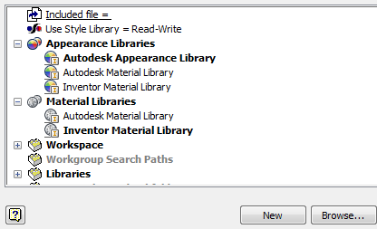

Libraries and projects
In the project file, declare material and appearance libraries that you want associated to the project. The Material and the Appearance sections require at least one material library. If only one exists, you cannot delete it until you add a different library.
Material and Appearance libraries are separate from other libraries, such as Style Libraries, referenced in a project. Libraries installed with Autodesk products are Read-Only. You can set your custom libraries to Read Only or Read Write using the file attribute.
You can create a custom material library, and set it as the active library for your project. To make a custom library read-only, use the Windows Explorer file property, and set the library file attribute to Read-only. All material library file names have the extension .adsklib.
Active Library
In the project editor, the name of the active library displays in bold letters. If a library has both materials and appearances, you can add it to both Material and Appearance Library sections. They can be active at the same time. The active library populates the controls wherever Inventor lists or uses a materials list, including the QAT (Quick Access Toolbar). If there is only one library in the project file, it is, by default, the active library. You can remove the active library unless it is the only library listed. The library listed above the active library inherits the active status.
You can explore other libraries by selecting one from the list or navigating to it using the Open Existing Library browser command.
