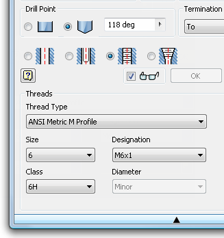

  9. Select the Tapped Hole option. Set the Thread Type to ANSI Metric M Profile, the Size to 6, and the Designation to M6x1.
  10. Select To in the Termination option to terminate the tapped holes on the center holes.
  11. Select an inside face of one of the existing holes to satisfy the termination selection. Make sure the check box in the dialog box is selected as shown here, or the operation fails. Click the OK button to create the holes and exit the Hole command.
