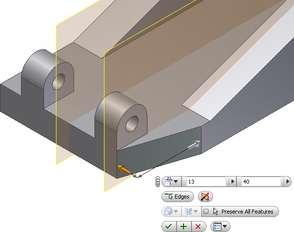

    We now create two chamfers on the front of the base to create a smaller footprint for the front of the base. To determine the chamfer distance, we use the Measure Distance command to extract the distance between the two planes.
  16. Start the Measure Distance command. You will find this command in the marking menu, or on the Measure panel of the Tools tab. Select the plane on the outside of the part and the plane on the front face of the small mounting tab. The distance between the two faces displays as 13 mm. We will use this distance to create a chamfer that terminates at the edge of this feature and the edge of the mirrored copy.
  17. Start the Chamfer command. Select the Two Distances option from the fly-out button on the mini-toolbar.
  18. In the left value input box in the mini-toolbar, enter a value of 13 mm for Distance 1, and a value of 40 mm for Distance 2 in the right value input box. Click the Edges button and select the vertical edge on the outside of the part. If your preview image does not look like the preview in the following image, reverse the values for the distance input, or use the flip direction arrow to reverse the reference face.
  19. Click the green Apply button (+) to create the chamfer and stay in the Chamfer command. Select the opposite outside edge to create the second chamfer. Reverse the input values, or use the flip direction button to achieve the desired results.
