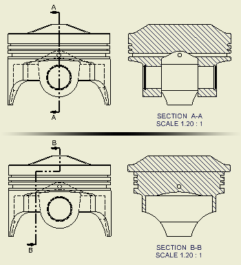

When you create a section view, you draw a line that defines where to cut the section view. A section view can also be created by specifying a line in a drawing sketch that is associated with the parent view.
A view cutting line knows what types of views can be projected from it. Depending on how the line is created, it can define the type of section view or define a boundary for a partial view.
The length of the cutting line defines the extent of the section view. A cutting line that passes only partially through the model view results in a partial section view.
If you draw the view cutting line outside the parent view, it defines a plane from which to project an auxiliary view.

View cutting lines
As you draw a view cutting line, constraints to features and edges are inferred as you move the cursor. If you place a point while an inference line is displayed, the constraint is automatically applied.
After you complete the view cutting line, the available views preview as you move the cursor in the graphics window. After you place the view, it can be moved only within the limits of view cutting line constraints.

Section view alignment
A view defined by a view cutting line is usually aligned to the parent view. It can be moved within the alignment constraint. If you remove the alignment, the view can be moved freely in the drawing, and the view cutting line with its arrowheads and text label are displayed on the parent view.
