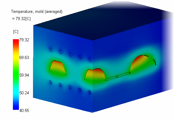

Review Mold Temperature Results
In this task, you interpret the temperature, mold (averaged) results.
  1. Ensure that all results are off.
  2. Ensure that only the Mold Tetras layer is on.
  3. Click Temperature, mold (averaged).
  4. Click Results > Cutting Plane > Edit.
    • Check Plane YZ, then Make active.
    • Click the To a Point tab.
    • Enter 0 -50 in the point field and click Apply.
    • Uncheck Show Active plane.
  5. Click Results > Cutting Plane > Edit.
    • Check Plane ZX, then Make active.
  6. On the Cutting Planes dialog box, Select a plane and click Flip as necessary so the most of the mold is still visible.
