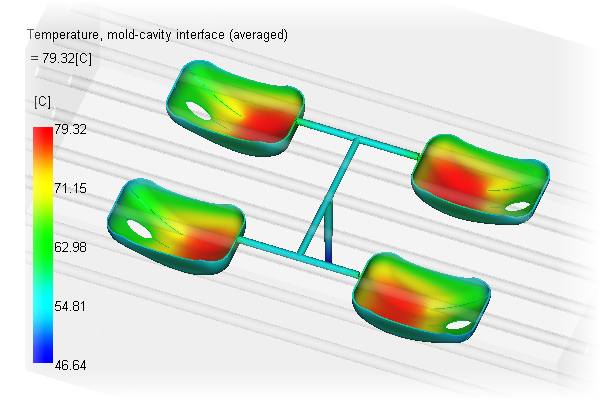

In this tutorial, you set up and run a finite element method (FEM) cooling analysis on a 4-cavity tool on the computer mouse cover. The FEM cooling analysis calculates both steady state and transient mold temperatures. Steady state is an average mold temperature. With transient, the mold temperature changes over time. In this tutorial, you run a steady state analysis. The mesh part model is provided. You create the cooling channels and mold in Synergy.

Input the process settings and run the analysis
Review results
