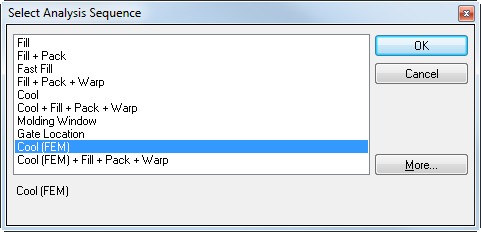

In this task, you use the set the analysis sequence to Cool(FEM). This sequence must be sent so the mold can be created.
  1. Click Home > Molding Process Setup > Analysis Sequence.
  2. Click Cool(FEM).
    Note: If you do not see an analysis sequence, click More to see all that are available for the molding process.
  3. Click OK.
