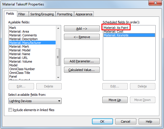

- For quantity reporting and scheduling, materials that are applied with the paint tool are distinguishable from those that are used as the body material of host object elements. See Creating a Material Takeoff Schedule.
