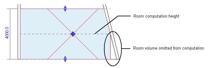

When volume computation is turned on, Revit LT shows the actual boundaries used to compute the volume of the room. These boundaries include sloping elements, such as the walls, ceiling, and roof.
Section view of a room when volume computation is turned on
In a section view, you can also check whether Revit LT is omitting parts of the room from its volume computations. This may be caused by a combination of sloping walls and the computation height that is defined for the corresponding level, or by other situations. See Computation Height and Situations That Can Affect Room Volume Computations.
