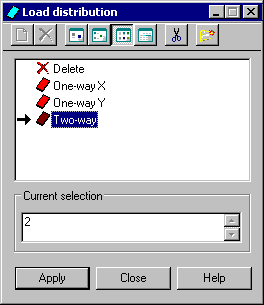

The list field displays 3 available types of load distribution based on the load direction:

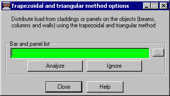

Loads from claddings are distributed on all objects in the contour and plane of a cladding:
You can select objects that lie in the plane of a cladding (or of a panel for which the trapezoidal and triangular distribution is selected in a calculation model) and do not carry loads. In a real structure, these can be elements of roof bracing that do not carry the load transferred from the roofing. You can select objects using either of the following ways:
Click (...) to open the Selection dialog.
