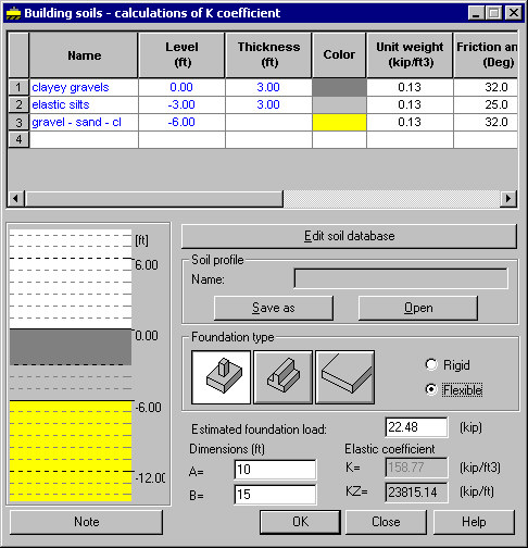

In the calculator, the K coefficient is calculated based on the value of average stresses under the foundation for an area unit. The equivalent KZ coefficient for a foundation with specified dimensions is also computed.
To compute the equivalent K coefficient for a layered soil, do the following.
Spread footing with dimensions A x B. The KZ coefficient unit is (force/length). A computed value KZ = K * A * B may be applied while defining the elastic coefficient in the support definition dialog.
Continuous footing with dimensions A (continuous footing length) and B (continuous footing width). The KZ coefficient unit is (force/length^2). A computed value KZ = K * B may be applied while defining the elastic coefficient in the elastic ground type definition dialog.
Slab foundation with dimensions A x B. The KZ coefficient unit is (force/length^3). A computed value KZ = K may be applied while defining the elastic coefficient in the panel thickness type definition dialog. This assumes either an average stress under the foundation from the rigid foundation solution, or from the solution of the elastic semi-space loaded with uniform loads acting on the region defined by the foundation contour. Differences in stress values result in different values of elastic settlement, and in turn, translates into a numerical value of elastic stiffness of the soil. Stress distribution under real structures is closer to the rigid foundation case than to the flexible foundation case.
Press Tab key or click OK. A value of the equivalent coefficient for a layered soil will be specified in the K = field.
Clicking OK causes a computed value of the KZ coefficient to be forwarded to the New support definition, New elastic ground or New thickness definition dialogs. This is provided that the relevant dialog is open and the elastic coefficient field is accessible.
Defined soil profiles can be saved on the disk. Click Save as to save a profile to a *.xml (database) file. The File name field displays the current soil profile with a file access path. Click Open to read a file with defined soil profile parameters.
