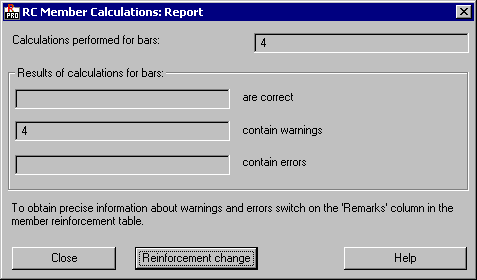

After the process of RC member design is complete, the RC Member Calculations: Report dialog displays.
This dialog contains the following information.
The Calculations performed for bars field displays the numbers of RC members that underwent design. These members must be an RC beam or RC column. A theoretical (required) area of reinforcement in RC members can be determined only for them. Other element types that will be entered on the design element list in the Calculations dialog box are ignored automatically.
The next three fields present information concerning the run of RC member calculations. They divide the members into groups sharing identical calculation results.
If errors or warnings occurred during RC member calculations, a message displays instructing you how to obtain information regarding the errors or warnings.
If at least one of the designed elements has been a beam bent to the Z axis or a beam bent biaxially, a message displays instructing how the results for such elements are presented in the result table.
Clicking Reinforcement change opens the Change of reinforcement dialog. It is accessible only if calculations of RC member reinforcement have been performed according to the code which enables calculation of deflections. At least one of the bars must not have been verified due to deflection.
