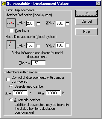

Serviceability - Displacement Values (CB71 Code)
Click Service in the Member Definition - Parameters dialog to define additional code parameters determining displacement values (limit displacements) for timber members.
You can define the following limit displacements:
While determining member limit deflections, a member can be defined as a cantilever.
In certain structures it is necessary to increase displacements of structure nodes. The global coefficient Theta has been introduced due to this. Theta causes an increase in all displacements (the default value of the coefficient equals 1.5).
Note: The coefficient value is always θ ≥ 1.
Each node displacement can be calculated as:
In the lower part of the dialog, you can define parameters of members with camber:
