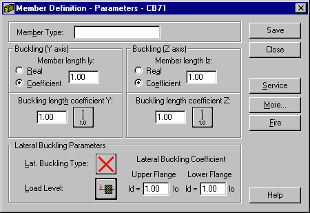

Click Parameters in the Definition dialog or select New Bar Type located in the Timber Bar Type dialog to define timber member type parameters for the French code CB71. The following timber codes are also available: Eurocode 5, French Eurocode 5, Finnish Eurocode 5, and Polish code PN-B-03150:2000.
The name of the selected timber bar type is given in the bar type field (any may be entered). Define the length of the bar for the appropriate plane in the fields Buckling with respect to axis Y or Z. Two methods of assigning this length are possible.
The second (coefficient) method is very useful to simultaneously define several bars whose actual lengths differ. If the set parameters are to be retained as a category entering the length in this way is necessary. Entering 1.0 guarantees that each bar defined with Ly will have its actual length accepted.
The buckling length coefficients of the bar may be defined in both directions in the Buckling Length Coefficient field. The actual bar length is automatically entered in either field (or the sum of the component bar lengths).
The buckling length coefficient depends on the support conditions of the bar end nodes. The buckling length of the bar may also be defined in the Buckling Models dialog, opened by the schematically representative button of the selected buckling model type. Typical bar support types defined by the code are located there and once selected, the coefficient value will be accepted or calculated automatically. Buckling is always included in the calculations if a compression force is present in the bar, even if it is negligible in relation to other internal forces. To eliminate buckling effects from the calculations, the last button must be selected from the Buckling Model, ignoring buckling in the calculation process.
Lateral buckling type, load level, and lateral buckling length coefficients are used during the verification of lateral buckling of the bar and may be selected in the Lateral Buckling Parameters field.
The Lateral Buckling Type defines the appropriate lateral buckling code parameters depending on the static bar model. In accordance with the code requirements, one of the models included in the code should be accepted. Model buttons reflect the corresponding code positions. The last of which ignores the lateral buckling effects during calculations.
To define lateral buckling conditions, it is also necessary to provide the load application level. The ordinate height of the load application is defined in the bar section axis. Assuming that lateral buckling occurs when loading the bar in the XZ plane, only the relative value in the interval <-1.0,1.0> coordinate needs to be entered. It is the. If the load is applied in a characteristic section point (upper shelf, lower shelf, and others) it is enough to select the appropriate button. The coordinate value will be accepted automatically.
Lateral Buckling calculations necessitate providing lengths for the bar section secured against torsion (lateral buckling). Due to the possibility of attaching the upper shelf and the lower shelf separately and the compressive stresses in the upper or lower shelf in various load cases, two lateral buckling lengths are accepted. Coefficients, through which the base bar length should be multiplied to obtain the lateral buckling length Lz, are taken as the base length. The coefficient value may be added directly or the button with the typical attachment case may be selected.
