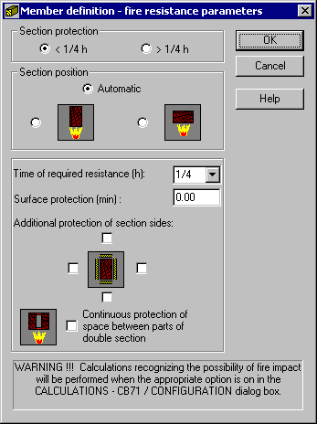

Fire
Click Fire in the Member definition - parameters dialog to determine the fire rating parameters of a timber member type.
The following member parameters related to fire rating can be defined:
If a timber section constitutes a double section, then the space along the entire beam/column length between this section is protected.
Note: Calculations taking fire impact into account will be performed if Calculations recognizing the possibility of fire impact is selected in the Configuration dialog.
