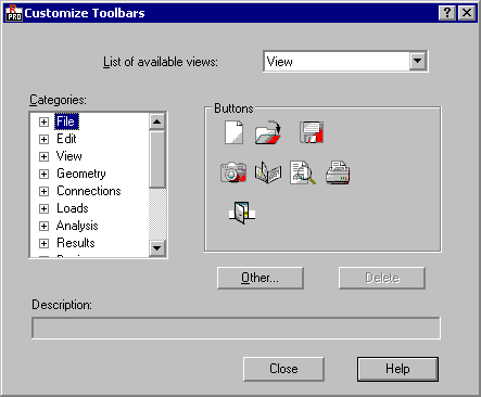

Open the Customize Toolbars dialog, which lets you customize the Robot system toolbar, by clicking Tools menu > Customize > Customize Toolbars.
After the View (available from the module in which the dialog box was open) is selected, appropriate commands for opening submenus and buttons that are defined for each category are displayed in the fields:
List of menu commands that open the submenu, combo boxes, and toolbars defined in Robot. For each category, buttons defined previously are displayed in the Buttons field.
To define a new button for the selected category, click Other.
List of buttons that have not been defined in the selected view.
The dialog also has buttons:
Delete
Removes the selected button from the category and the Robot toolbar.
Close
Help.
To define a new button, toolbar, or control in the menu, click the selected object and move it to the appropriate place in the menu (keeping the button pressed).
