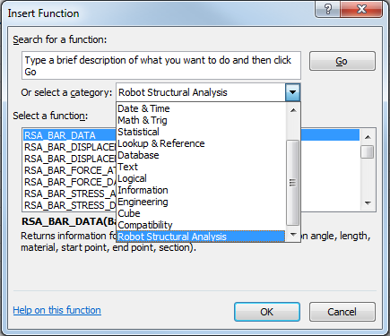

Insert function dialog
The Insert function dialog allows you to insert a formula in the worksheet.
Access
    You can access it from:
  • Ribbon - by clicking Formulas tab Function library panel Insert Function
  • Formula Bar - by clicking Insert Function icon.
Insert function
The Insert function dialog contains the following sections:
Search for a function or select a category
Search a function or select a category for formula from the drop-down list.
Select a function
Select a formula from the list.
Note: Description for selected formula is displayed below.
Click Help on this function link to get more information about the selected formula.

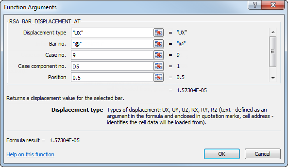

Function Arguments
After selecting a category and formula the Function Arguments dialog opens.
The Function Arguments allows you to define arguments for selected formula and contains the following sections:
Note: The available arguments depends on the selected formula.
Formula - arguments
Specify arguments for the selected formula.
    You can specify the following arguments:
  • number of the selected element (Bar number, Node number, Case number, etc.)
  • value which you want to obtain (Displacement, Force, Stress, etc.)
  • type of information which you want to return (Length, Extremum, Material, etc.)
  • type of object (Bar, Node, etc.)
  • and others (such as Position, Section name, Object index etc.).
    You can define an argument in the following ways:
  • type a number or text in the box
    Note: If the text is defined as an argument in the formula, it must be enclosed in quotation marks.
  • type or select a cell address where data is defined
    Note: If you select the cell address in Microsoft Excel then the cell or range is detected automatically.
  • Note: The available methods depend on the selected argument.
Formula - descriptions
Displays a description of what the function does, together with any required or optional arguments.
Note: The description depends on the selected argument. As you click in the text box for each formula argument, the dialog will give you a description of what is expected for that particular argument.
During the definition of arguments, in the dialog you can check the value returned for this formula.
