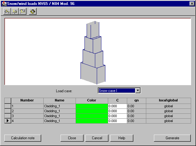

After clicking Apply in the Parameters of 3D snow/wind loads dialog, the following displays:
The dialog displays a view of the structure and the list of generated snow/wind load cases. The structure view is generated using the Open GL view. It shows loaded planes using a color legend.
You can select a case to display from the Load case list. The case list has only snow and wind loads,which means these loads are assigned wind and snow natures.
All structure faces are displayed in the table. For the faces that are not automatically loaded by Robot, the load value is zero.
For wind load cases defined according to the NV 65 code, the table provides the following data:
You can modify the values of the following parameters in the dialog: Ce, Ci, Delta, and QH. The values displayed in the Ce-Ci and qr(z) fields are recalculated after the changes are made in the table fields.
For snow load cases defined according to the NV 65 code, the table provides the following data:
For cases that are not assigned a snow or wind nature, the table is empty. Similar to a wind load case, you can modify some coefficients.
After you click Generate, the dialog closes and the loads are generated on the surfaces. The loads are applied in the form of pressure on planar objects in the local or global system. Next, the loads are transferred onto bars similar to generating loads on bars from 3D objects. Loads are transferred onto bars when generating the model of the structure.
The set of coefficients used to determine a snow/wind load is saved in the project, so you can edit the coefficients and parameters of a snow or wind load.
Clicking Calculation note generates a text file with the parameter values saved for all snow and wind load cases. The note opens in the text editor of Robot.
