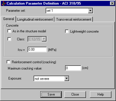

Click New set of calculation parameters in the Calculation parameters dialog to access RC member calculation parameters.
Parameters needed for RC member design that are not connected with its geometry such as: steel and concrete characteristics, used member types, and covers are grouped. Remaining code parameters depending on geometry are defined in a RC member type.
The dialog has the following tabs:
- General. Parameters of concrete (in the Concrete field) and additional parameters needed in calculations.
- Longitudinal reinforcement. Steel parameters, member types and covers to the edge or bottom reinforcement axis can be defined.
- Transversal reinforcement. Steel parameters for transversal reinforcement, reinforcement type and its parameters can be defined.
Part of this data depends on a code you have selected. The dialog will express this appropriately.
