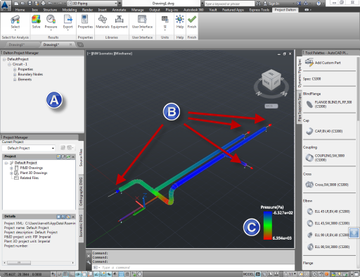

Dalton for Autodesk Plant3D is a pipe network analysis solution which simulates the flow behavior in a distribution network. Because Dalton is a plug-in, you can run a flow simulation on your model without leaving the AutoCAD Plant3D environment.
After opening your model in AutoCAD Plant3D, click Plug-Ins > Dalton to start Project Dalton.
A new Project Dalton tab is displayed in the ribbon.
In addition to the options available in the Project Dalton tab, Dalton also contains User Interface components that you can access by clicking
User Interface panel > User Interface.
