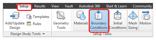

1. Click Boundary Conditions on the Setup tab:

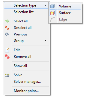

2. Right click off the model. Click Selection type, and Volume.

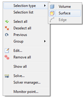

4. Right click off the model. Click Selection type, and Surface.

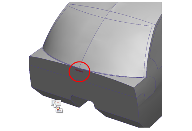

5. Cold air enters the cabin through the rectangular opening below the windshield. We will assign a temperature and a flow rate to this surface. Select this surface and click the Edit button in the context toolbar.

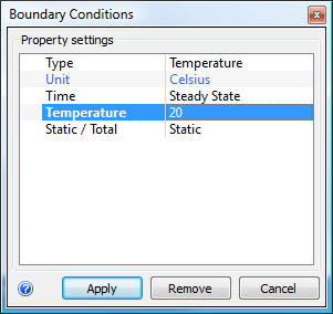

6. Type = Temperature, Unit = Celsius, Temperature = 20. Click Apply.

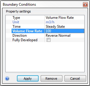

8. Right click, and select Edit...

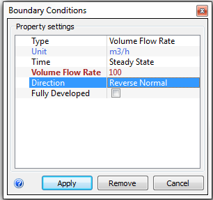

9. Type = Volume Flow Rate, Unit = m3/h, Volume Flow Rate = 100.

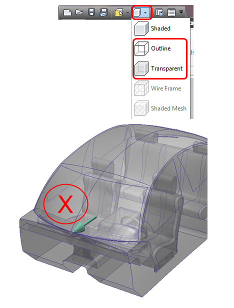

10. To ensure the flow direction is correct, display the model as Outline or Transparent from the Quick Access toolbar. Observe the flow direction arrow. If it is incorrect, click Reverse Normal in the Direction line of the Boundary Conditions dialog. Click Apply.

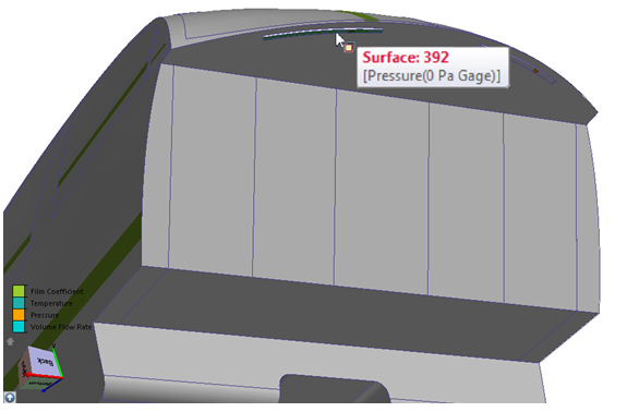

11. Change the model appearance back to Shaded, and rotate the model. Select the two arc surfaces at the rear of the cabin. Click the Edit button in the context toolbar.
Note: Flow leaves the cabin from here.
12. Type = Pressure, Pressure = 0. Click Apply.

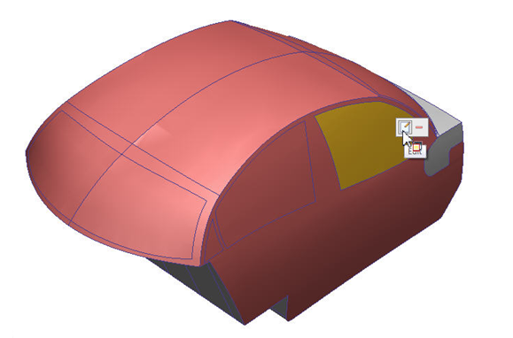

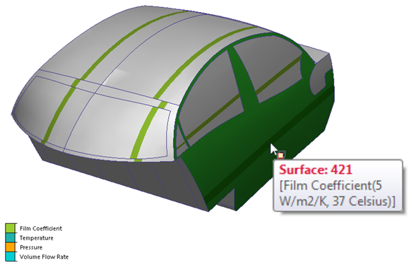

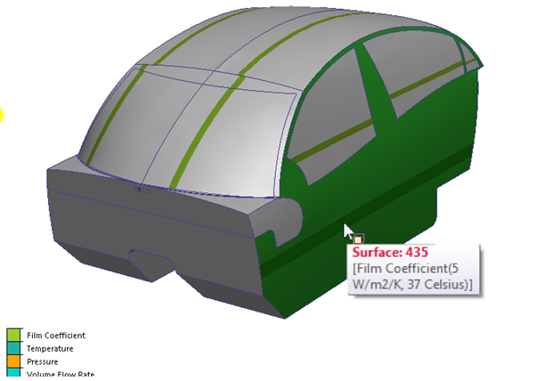

13. To simulate a stationary vehicle in hot conditions, apply a film coefficient to the sides and top of the passenger cabin. Select the following surfaces, and click the Edit button on the context toolbar:

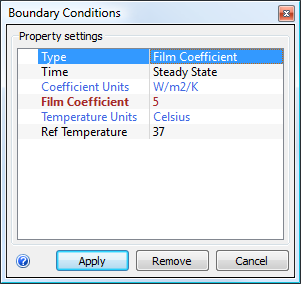

14. Type = Film Coefficient, Coefficient Units = W/m2/K, Film Coefficient = 5, Temperature Units = Celsius, Ref Temperature = 37. Click Apply.
Note: This analysis assumes a worst-case approximation of heat transfer to the outside environment. A more detailed and precise study of heat loss to the environment is possible in Autodesk Simulation CFD. It would require modeling the airspace around the vehicle. Many times this is not necessary, as a conservative estimate of heat loss – the approach used here - will provide a worst-case scenario in a much shorter time. This provides more time for comparisons of alternate designs.

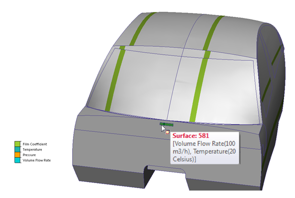

15. Confirm all correct boundary conditions are applied:
