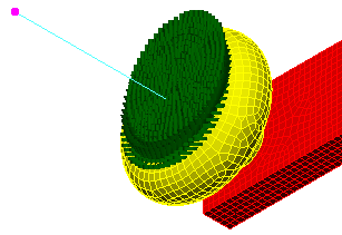

  1. With the  Selection Shape Point or Rectangle and  Selection Select Vertices commands active, click the node at the free end of the beam element that is perpendicular to the top surface of the knob, as shown below.
  2. Click Setup Loads Moment.
    • Type 200 in the Magnitude field
    • Select the Y radio button.
    • Click OK.

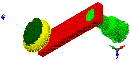

The model should display as shown in the following image.
