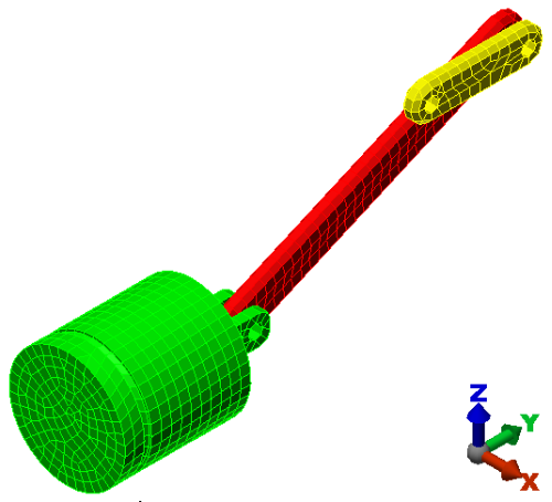

    2. Click Mesh model. The meshing process starts.  When asked to review the mesh results, click No. The meshed model displays as shown in the following image.
  2. Use the  View Navigate Orbit Orbit,  View Navigate Zoom Zoom, and View Navigate Pan commands (or the related ViewCube or Navigation Bar tools) to inspect the mesh in various areas of the model.
Note: Even though the default mesh type is Solid, only the surface mesh has been created at this point.  By default, the generation of the interior mesh lines is postponed until the first time the Run Simulation or Check Model command is executed.
