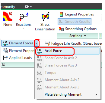

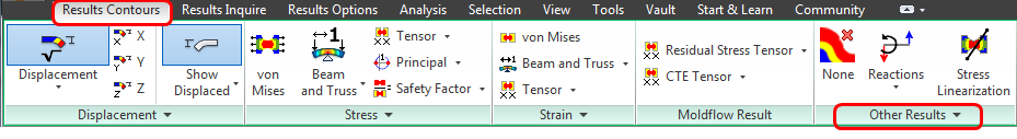

1. To view the contact forces, expand the Other Results drop-down menu.
Expand the Element Forces menu, and select Axial Force.

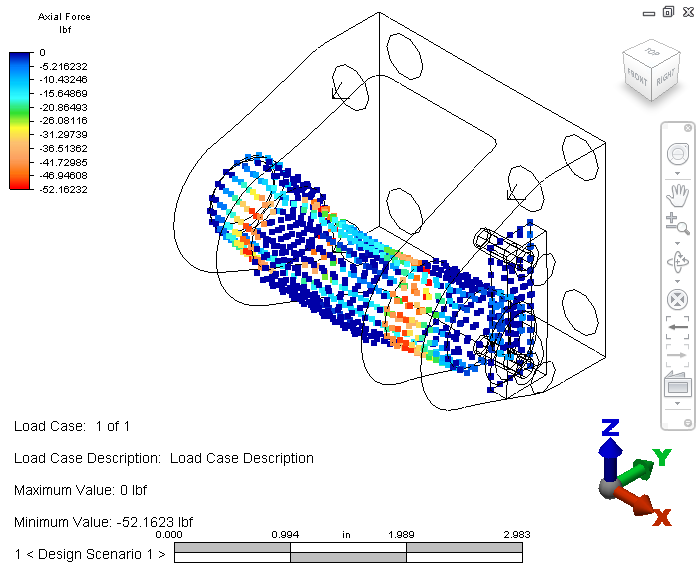

You should see this…
Because the forces are all compressive or 0, the legend is a little misleading because it shows the highest value (which is 0) at red.

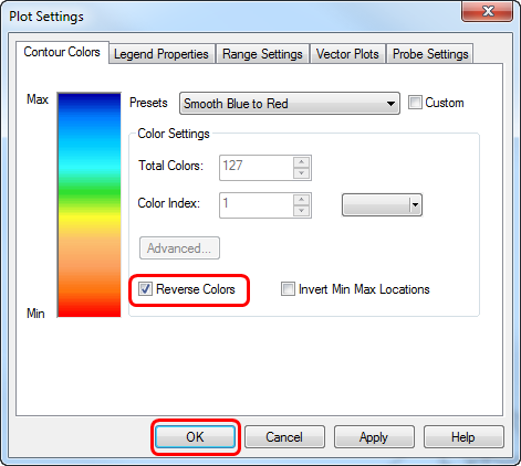

2. To invert the legend, click Legend Properties from the Settings panel. On the Plot Settings dialog box, check Reverse Colors, and OK.

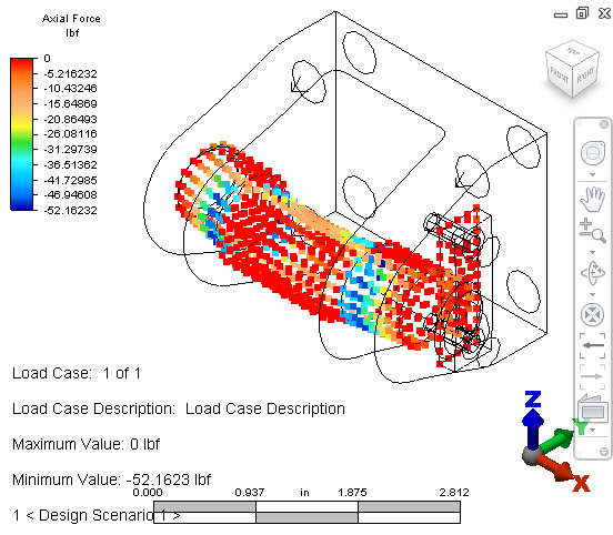

From this plot, we can see that the greatest contact forces occur where the pin contacts the clevis.
