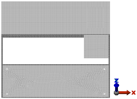

  1. Of the ViewCube, click near the middle of the edge where the Front and Top faces meet. This will produce an oblique view of the model (rotated half-way between the Front and Top views), as shown below.
    Tip: Clickable zones on the ViewCube (which includes faces, edges, and corners) will turn light blue when the cursor is over them. Clicking edges produces various oblique views and clicking corners produces various isometric views.
    Note: The view shown above provides good visibility of the holes in the bottom surface. The holes would be harder to see in a Bottom view because of the green surfaces that would be in the background from that viewpoint. Here, we see only white background beyond the holes.

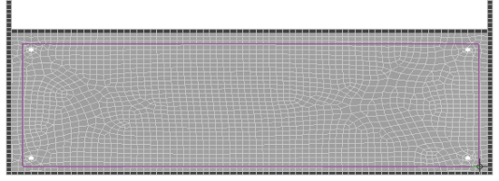

  2. With the  Selection Shape Point or Rectangle and  Selection Select Edges commands active, click and drag to draw a selection rectangle that encloses the four holes in the bottom of the case, as shown below.
    All four holes should now have magenta edges, indicating that these edges are selected.

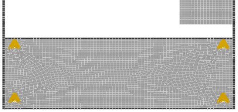

  3. Click Setup Constraints General Constraint.
    • Click the Fixed button.
    • Click OK. The fixed constraint glyphs appear as shown below.
