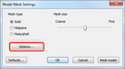

1. Click Mesh > 3D Mesh Settings.
2. Click Options...

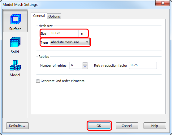

3. Set the Type to Absolute mesh size. Enter a size of 0.125, and click OK.

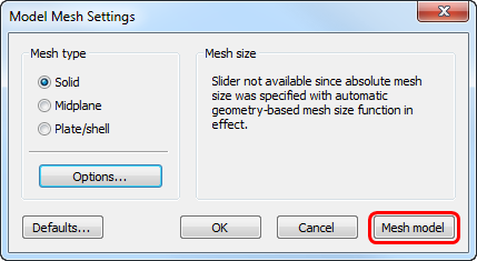

4. Click Mesh model.
5. When asked if you want to view the meshing results, click No.

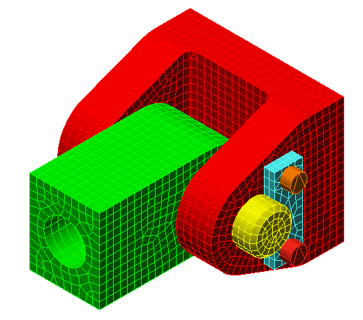

What it should look like...
