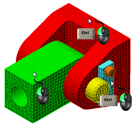

1. From the ribbon, click Selection (tab) > Select (panel) > Parts.
2. Select the rod eye. While holding Ctrl, select the clevis and retainer.

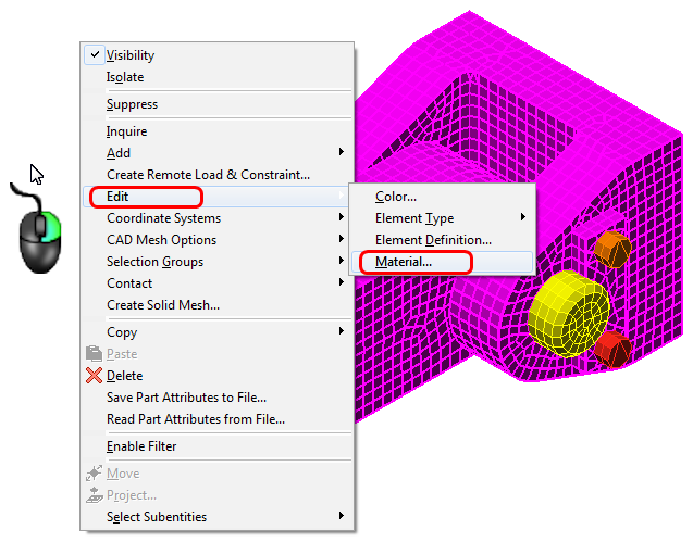

3. Right-click in the display area, and select Edit > Material.

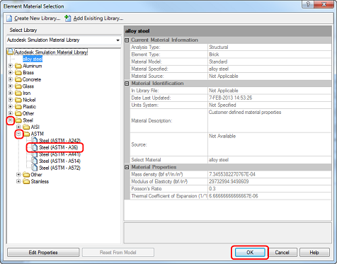

4. Expand the Steel and ASTM branches. Select Steel (ASTM - A36), and click OK.
5. When asked to confirm, click Yes.

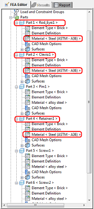

What it should look like…
