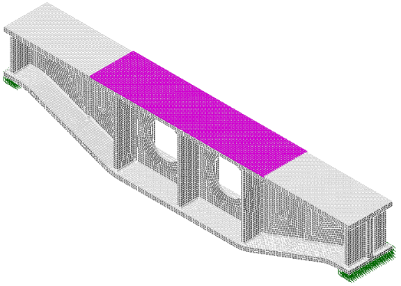

Apply the Surface Force
Click the
Home
icon above and to the left of the view cube for an isometric view of the model.
Click the top, middle surface of the beam, as shown below.
Click
Setup
Loads
Force
Type
250000
in the
Magnitude
field.
Click
OK
Next
