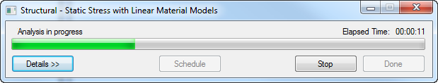

  2. Click Analysis Run Simulation.

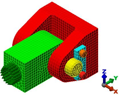

  3. The first time an analysis is run, the solid mesh is generated within the interior of each part. When solid meshing is complete, an analysis progress bar appears. Click the Details button to display or hide the analysis summary details:

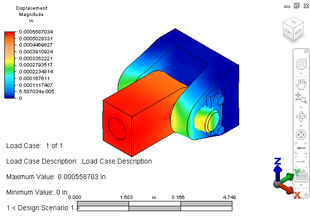

The solver iterates to determine which contact points are closed and which are open. When the solution is complete, the model displays in the Results environment with the displacement magnitude shown by default:
Next, we explore some results visualization tools…
