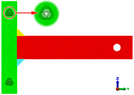

  4. Press ESC to clear the selection. The model displays as shown in the following image.
