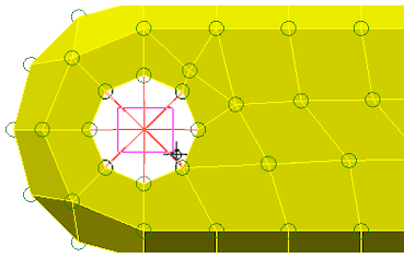

  3. With the  Selection Shape Point or Rectangle and  Selection Select Vertices commands active, click and drag to draw a box enclosing the center of the joint.

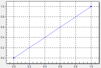

    3. Click the Curve button.
      • The default curve ramps up the multiplier from 0 to 1 in 1 second.  This is what we want. The curve within the dialog should look like the image below.
      • Click OK to exit the Multiplier Table Editor.
