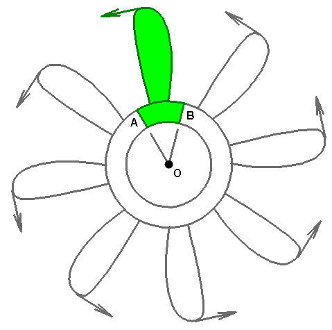

Cyclic symmetry occurs when the geometry, loads, constraints and results of a partial model can be copied around an axis to give the complete model. A typical example is a fan blade or turbine. If the loads on the blades and geometry repeat, only one blade needs to be modeled instead of the entire hub of X blades. See Figure 1. The result is a smaller analysis which takes less time to analyze.
Figure 1: Cyclic Symmetry Example (the highlighted section, including the load, can be copied 7 times about the axis O to create the full model)
In particular, cyclic symmetry forces the radial, tangential, and axial displacements at the nodes on one face (A in Figure 1) to match the same nodes on the opposite face (B in Figure 1).
