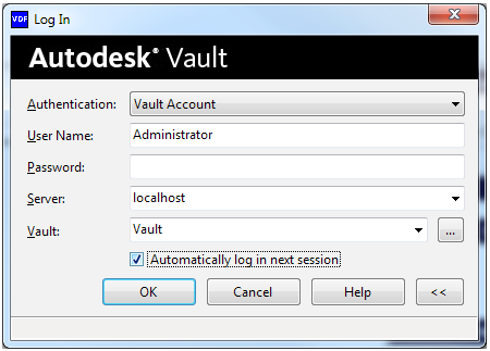

Log in Dialog
Provides functionality for logging into a vault.

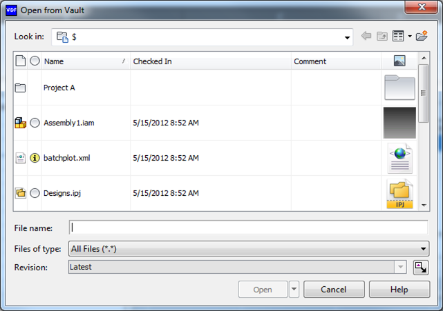

Select Entity from Vault Dialog
Allows users to navigate the vault and select an entity for an event.
Vault Browse Control
Displays detailed information about the files, folders, items, and other objects stored within the vault.

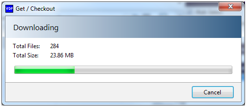

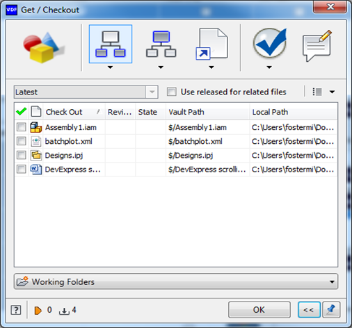

Download and Check out
Allows users to obtain a copy of an entity in a vault. The copy can be downloaded to a local working folder, checked out of the vault but not downloaded, or both.

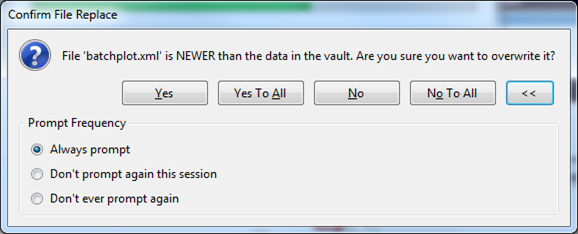

Prompt Dialogs and Management
Presents questions to the user in a uniform interface, and allows them to save their response so that they do not have to respond to the prompt again.

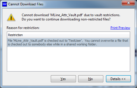

Restriction Dialog
Displays restrictions to the user in a uniform dialog if an operation cannot be completed .
