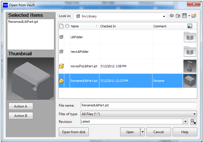

Configurable Text
The following elements can have their text replaced by user-specified values:
  • Dialog Caption
    For example, in the dialog image, the Dialog Caption is configured as "Open from Vault."
  • Selection Label
    For example, in the dialog image, the Selection Label is configured as "File name."
  • Initial Selection
    The initial value of the text box next to the Selection Label.
  • Selection Filter Label
    For example, in the dialog image, the Selection Filter Label is configured as "Files of Type."
  • Action Button Text
    For example, in the dialog image, the Action Button text is configured as "Open."
