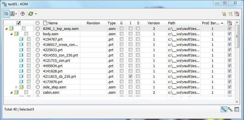

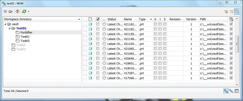

The Workspace Browser shows the workspace folder structure. The current workspace is blue. Unselected sub-workspaces are gray.
The Session Browser shows the currently loaded files in Pro/ENGINEER.
