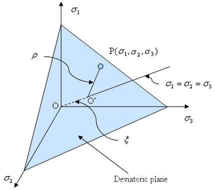

It is convenient to work in the principal stress space, where any stress state is defined by Haigh-Westergaard coordinate (x, r, q):
where I 1 =δ ij σ ij , J2=0.5S ij S ij , J3=(S ij S jk S ki )/3, and S ij =σ ij - (δ ij σ kk )/3.
 (a) Principal stress space |
 (b) Deviatoric plane with principal stress projected on |
| Figure 2: Haigh-Westergaard Stress Coordinates |

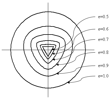

where f t ' and f c ' are the uniaxial tensile and compressive strength (absolute values), respectively; and e is the eccentricity as defined by Kang and Willam:

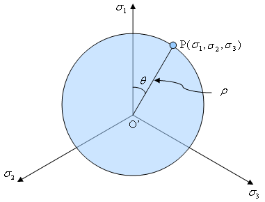

where c 0 is a material constant that can be calibrate from experiments (it is set to 5.5 in Kang and Willam, reference 5). The equi-triaxial tensile strength ζ 0 =sqrt(3)f t '. The eccentricity of 1 is a circle in the deviatoric plane (Figure 3) and failure is then independent of the Lode angle ϑ.

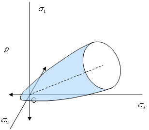

In addition, the analysis also assumes no yielding for tension-dominant status via introducing a tension cut-off (maximum tensile stress, or the Rankine criterion). In the mixed tension-compression region (reference 1), the yielding surfaces gradually evolve. The failure envelop is thus an open surface in the principal stress space as demonstrated in Figure 3. The analysis always assumes the failure is cracking when principal tensile stress exists. This is a little arbitrary since concrete fails in complicated ways and as a result some studies do not distinguish the failure types.
 (a) Concrete failure envelope |
 (b) Deviatoric view of concrete failure envelope |
| Figure 3: Failure Envelope |

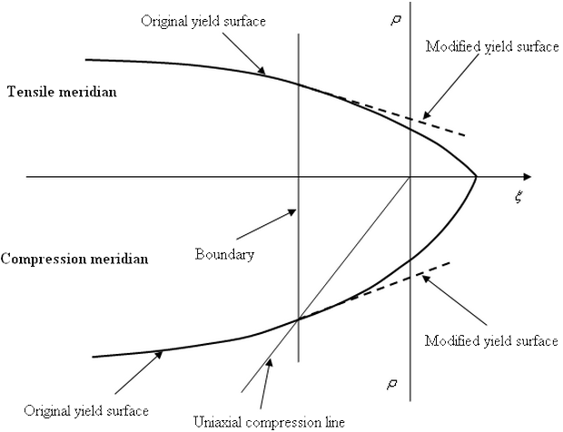

In the mixed tension and compression domain (reference 1), the yield surface is modified to be the tangential surface to the original at the boundary (Figure 4).
| Figure 4: Yield Surface in Mixed Tension-Compression Domain |
