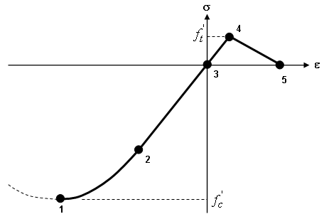

The reinforced concrete material model is treated as statistically homogeneous with different tensile and compressive behaviors. It follows a smeared crack model where cracking and crushing are simulated via degeneration of the elasticity at integration points instead of tracking individual macroscopic cracks. (Cracks can occur in up to three different orthogonal planes at each integration point of each element. The number of integration points are set on the Element Definition.) The model described here is intended for relatively monotonic loadings. (A true monotonic load either increases or decreases but does not reverse.) In the current model, cracking is considered the most important aspect, but compression under confinement is also reasonably accounted for. See Figure 1.

 Figure 1: Idealized Uniaxial Behavior of Plain Concrete

-  Young's modulus Enter the Young's modulus. This is the slope of the stress versus strain curve of a material in the elastic region (points 2-3-4 in Figure 1). It is also referred to as the modulus of elasticity. This value must be greater than zero.

-  Uniaxial Tensile Strength Enter the strength (breaking stress) of the concrete subjected to an uniaxial tensile load (point 4 in Figure 1). This value must be greater than zero.
-  Uniaxial Compressive Strength  Enter the strength (crushing stress) of the concrete subjected to an uniaxial compressive load (point 1 in Figure 1). This value is entered as a positive number and must be greater than zero.

-  Tension Stiffening This drop-down contains two options pertaining to the formation of cracks and what happens to the strength. When Fracture energy, Linear is chosen, enter the value for the Fracture energy/area of the plain concrete, which is the fracture energy (between the initiation of one crack and complete failure) per unit area. A value of zero is equivalent to setting the Tension Stiffening value to None. The fracture energy per volume is proportional to the area under the stress-strain curve from points 4 to 5 (see Figure 1), and multiplying this by the characteristic length gives the value of Fracture energy/area.

The input on the Hardening tab are for the plain concrete. This input describes the stress-strain curve of the concrete in compression after the elastic region (points 2 to 1 in Figure 1).
Enter the Strain and Stress values as negative values, starting at the yield point (point 2). Using the Sort button will sort the values in descending order (yield point to failure point). A minimum of two data points are required.
The entries on the first row (Index 1) is the yield point and are linked to the Young's modulus entered on the General tab. Therefore, the strain for the first row cannot be entered; it will be calculated by the processor as (Stress row 1)/(Young's modulus). The interface will calculate and enter the strain for the first row if you try to select that cell; the processor will calculate the initial strain regardless of the value entered.
