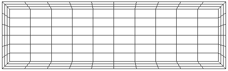

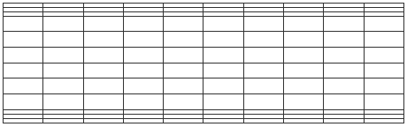

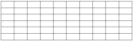

To produce a boundary layer mesh, set the type of solid mesh to Tetrahedra and wedges (boundary layer). (If not using the boundary layer mesh, the all tetrahedra mesh is next recommended for fluid flow models. See Selecting a Mesh Type above.)
By default, this option produces a boundary layer mesh on all surfaces. This thin layer of elements can create convergence problems in a fluid flow analysis if the fluid is passing normal to the layer of thin elements and then entering into normal size elements. This condition occurs at the following locations in a model:
In these situations, select the faces where a boundary layer mesh is NOT desired, right-click, and choose Exclude From Boundary Layer. That is, the boundary layer mesh should only be created at real walls. See the following figures, which depict the cross-section of a mesh inside a pipe.
