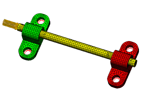

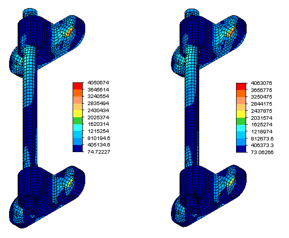

Figure 1 depicts the surface geometry of a three-part CAD assembly. This surface mesh resulted in a relatively large 0.00207 microhole volume fraction. Static Stress with Linear Material Models and Natural Frequency (Modal) analyses were conducted on this model, and on its fully filled counterpart. Figure 2 shows how similar stress results are obtained for both versions of the model. The modal analysis was utilized to obtain the first five natural frequencies, and, as Table 1 shows, both versions of the model again gave solutions with insignificant engineering differences.
Figure 1: FEA model, including mesh, of a three-part assembly of a circular rod bonded to two brackets, which are fixed using boundary conditions on the edges of the holes located on their flat ends (red triangles on the underside). In the Static Stress with Linear Material Models analysis, a surface force of 5.0 x 108 dynes is applied on one end of the rod (yellow arrows).
Figure 2: von Mises stress distributions obtained from the Static Stress with Linear Material Models analysis of a three-part assembly of a circular rod bonded to two brackets. The figure on the left is for the model without microholes, whereas that on the right is for the model with microholes. The latter predicts a maximum stress 0.31% greater than the former.

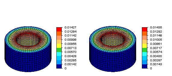

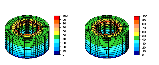

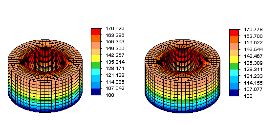

Figure 3 depicts the Steady-State Heat Transfer results of a single-part model of a ring with and without microholes. The microholes resulted in a more typical 0.00046 volume fraction. As in the Static Stress with Linear Material Models analysis, both versions of the model produced highly similar results. Figure 4 depicts displacement results obtained using Autodesk Simulation’s Mechanical Event Simulation (MES) software for the two versions of the ring model. Even for nonlinear FEA, the presence of microholes did not significantly affect the results. Finally, Figure 5 depicts voltage results obtained using Autodesk Simulation’s Electrostatic Current and Voltage analysis for the two versions of the model. As expected because of the underlying similarities between electrostatic and thermal analysis, the presence of microholes had little effect on the results.
Figure 3: Temperature distributions obtained from a Steady-State Heat Transfer analysis for ring model with the base maintained at 100 °F, and a heat flux of 0.642 BTU / (sec . in2) applied to the inner surface. The figure on the left is for the model without microholes, whereas that on the right is for the model with microholes. The latter predicts a maximum temperature 0.349 °F greater than the former.
Figure 4: Displacement magnitude distributions obtained from a Mechanical Event Simulation (MES) analysis for a ring model with the outer surface fixed and a time-proportional pressure reaching a maximum of 100 lb/in2 seconds applied on the inner surface. The results are at the end of a 0.1 second event. The figure on the left is for the model without microholes, whereas that on the right is for the model with microholes. The latter predicts a maximum nodal displacement 0.56% greater than the former.
Figure 5: Voltage distributions obtained from Electrostatic Current and Voltage analysis for ring model with a voltage of 100 V applied on the inner edge of top surface, and 0 V applied on the outer edge of the outer surface. The figure on the left is for the model without microholes, whereas that on the right is for the model with microholes. A comparison of the maximum voltage on the outer top edge shows a difference of 0.02% between the two models.
