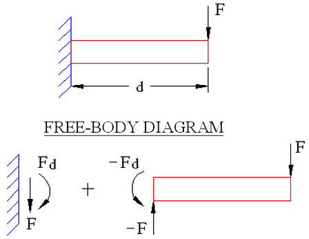

Typical stress analysis computations reveal nodal displacements and stresses acting on the finite elements. Sometimes, you might be interested in knowing how much force/moment the model exerts on the rest of the world. For example, a cantilever beam which is fixed at one end and subject to a vertical force at the other end gives rise to a reaction force/moment.
Figure 1: Free-Body Diagram of a Cantilever Beam
F = Reaction force exerted on wall by beam.
Fd = Reaction moment exerted on wall by beam.
