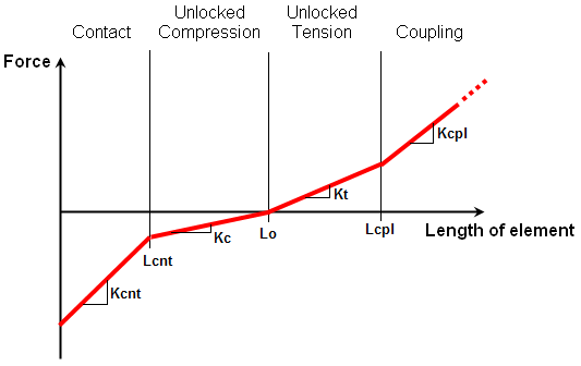

The general contact element has three basic states which results in an element with four distinct regions of stiffness:

In all cases (unlocked, contact, and coupling), the stiffness of the element will be the product of the modulus (E) and cross-sectional area (A) divided by the length (L), or stiffness = A*E/L. The length L depends on the length of the element as drawn in the model and the input lengths of contact distance and coupling length. Refer to the following figure and table.
| Figure 1: Stiffness of General Contact Element |
where
| Initial Element Length, Lo | |||
| Lo < Lcnt | Lcnt < Lo < Lcpl | Lo > Lcpl | |
| Stiffness, K | Kcnt = A*Ec/Lcnt + A*Ecnt/Lcnt no unlocked compression Kt = A*Et/Lcnt Kcpl = Kt + A*Ecpl/Lcpl | Kcnt = Kc + A*Ecnt/Lcnt Kc = A*Ec/Lo Kt = A*Et/Lo Kcpl = Kt + A*Ecpl/Lcpl | Kcnt = Kc + A*Ecnt/Lcnt Kc = A*Ec/Lo no unlocked tension Kcpl (for L>Lo) = A*Et/Lo + A*Ecpl/Lcpl Kcpl (for L<Lo) = A*Ec/Lo + A*Ecpl/Lcpl |
| Initial Force, Fo | Fo = 0 | Fo = 0 | Fo = Kcpl*(Lo-Lcpl) |
| where Ecnt, Ec, Et, and Ecpl are moduli for contact, unlocked compression, unlocked tension, and coupling, respectively. | |||
