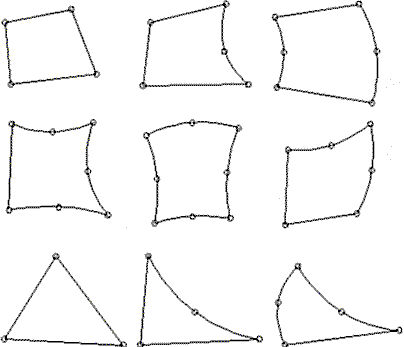

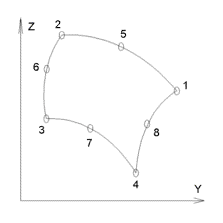

2D elements are 3- or 4-node isoparametric triangles or quadrilaterals which must be input in the global Y-Z plane. Figure 1 shows some typical 2D elements. The element can represent either planar or axisymmetric solids, as illustrated in Figure 2. In both cases, each element node has two translational degrees of freedom. When the element is used to represent an axisymmetric solid or shell, the global Z-axis is the axis of revolution. All elements must be located in the +Y half-plane where Y is the radius axis. Figure 2 illustrates these conventions.
Figure 1: Node Configuration for 2D Elements

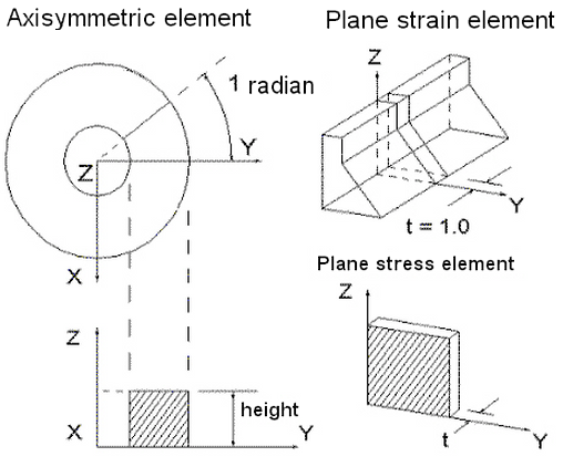

There are three types of 2D elements available for a nonlinear analysis. These can be selected in the Geometry Type drop-down box in the General tab of the Element Definition dialog.
-  Axisymmetric: Select this geometry type for elements that model solids with geometric, load and boundary condition symmetry about the Z axis. Negative Y coordinates are not admissible. If a node lies along the axis of revolution (the Z axis) the translation in the Y direction must be constrained. Nodal loads are normalized by the number of radians in a circle (load divided by radians).
Figure 1: 2D Axisymmetric Model
-  Plane Strain: Select this geometry type to model solids which exhibit no deflection normal to the YZ plane. Since no deflection in the X direction is assumed, a thickness of 1 unit is assumed for the analysis; a thickness can be entered, but this thickness is only used for the 3D visualization in the Results environment. All input loads and results are based on the 1 unit thickness.
Figure 2: 2D Plane Strain
-  Plane Stress: Select this geometry type to model solids of a specified thickness normal to the YZ plane which exhibit no stress normal to the YZ plane. The constitutive relations are modified to make the stress normal to the YZ plane zero. All loads are distributed uniformly across the thickness.
Figure 3: 2D Plane Stress Model

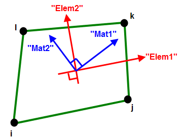

There are two sets of axes for 2D elements: the element axes and the material axes. In this paragraph, the element axes are designated as Elem1 and Elem2, and the material axes are designated as Mat1 and Mat2. Other sections of the documentation may refer to either set as axes 1 and 2.
For a general FEA analysis, you can ignore the element orientation (Elem1 and Elem2). The ability to orient elements is useful for elements with orthotropic material models. This is done in the Orientation tab of the Element Definition dialog. The Method drop-down box contains three options that can be used to specify which side of the element will be the ij side. If the Default option is selected, the side of an element with the highest surface number will be chosen as the ij side. If the Orient I Node option is selected, a coordinate must be defined in the Y Coordinate and Z Coordinate fields. The node on an element that is closest to this point will be designated as the i node. The j node will be the next node on the element traveling counterclockwise (right-hand rule about the +X axis). If the Orient IJ Side option is selected, a coordinate must be defined in the Y, and Z Coordinate fields. The side of an element that is closest to this point will be designated as the ij side. The i and j nodes will be assigned so that the j node can be reached by traveling counterclockwise along the element from the i node.

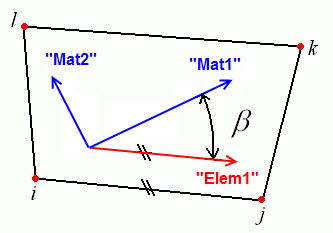

Once the ij side is determined, the element axis Elem1 is set to be parallel to the ij side. Axis Elem2 is +90 degrees about the X axis. See Figure 1.
Figure 1: Element Axes and Material Axes
The element axis Elem1 is parallel to the ij edge of the element.
The material axis Mat1 can be offset from the element axis.

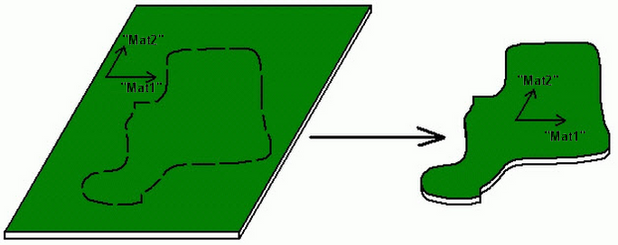

 Material Axis Direction: When the orthotropic material model is used for 2D elements, three material axes are defined. Material axes Mat1 and Mat2 are in the plane of the element, and Mat3 is parallel to the X axis.
There are two ways to define the material axes from the General tab of the Element Definition dialog. The first is to define a vector using the Y Direction  and Z Direction fields. Material axis 1 is parallel to the global vector. Material axis 2 will be the cross-product of the X axis and material axis 1. Figures 2 and 3 illustrate this method. If no value is specified in the Y Direction or Z Direction fields, the value in the Material Axis Rotation Angle field will be used to orient the material axes relative to the element axis Elem1. This is useful if a part was molded from an original sheet into a specific shape. The rotation angle β corresponds to the angle of material axis 1 relative to the element axis 1 of each element. See Figure 4.
Figure 2: Y and Z Direction Definition of Material Axis Direction
Figure 3: Part Cut Out From Orthotropic Material
Although the mesh will be random, resulting in random element axes, the material axes are consistent.

Tip: Use the Material Axis Direction on the General tab to set up the orientation of the material. See the paragraph Controlling the Orientation of 2D Elements above for details.
