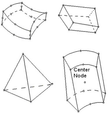

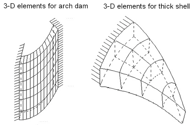

Brick elements are 8- to 21-node isoparametric or sub-parametric curvilinear hexahedra. Typical elements are illustrated in Figure 1. These elements may be used to model 3D solids or thick shells, such as the two examples in Figure 2.
Figure 1: Typical 3D Continuum Elements Derived from the General 21-Node Element
Figure 2: Typical Applications for 3D Elements
