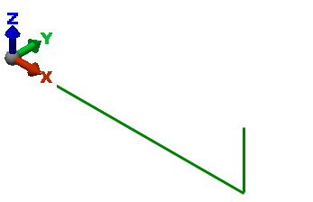

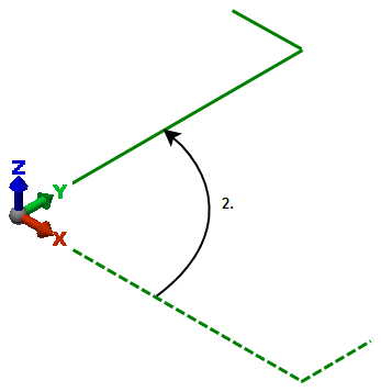

|  An L shaped beam starts in the XZ plane. |
|  First, the beam is rotated -90 degrees about the X axis. |
|  Second, the beam is rotated 90 degrees about the Z axis. |
|  Third, the beam is rotated 180 degrees about the Y axis. |
|  Fourth, the beam is rotated -90 degrees about the Z axis.
 Comparing the final position with the initial position, it seems that the final rotation results would be a net of +90 degrees about the X axis and 0 degrees about the Y and Z. In large deflection analyses, the results are -90 degrees about X, 180 degrees about Y, and 0 degrees about Z. Since the displacement results are path independent, the final displacement results are 0 in X, -L in Y and Z, where L is the length of the short leg. |

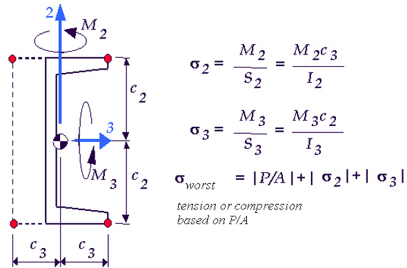

 Inquire Detailed Beam Stress and Results Inquire
 Detailed Beam Stress and Results Inquire Inquire
 Inquire Detailed Beam Strain in the Results environment to review the results.
 Detailed Beam Strain in the Results environment to review the results. Worst = (sign of P/A)(ABS(P/A)+ABS(M2/S2)+ABS(M3/S3))
A stress analysis (both linear and nonlinear) assumes the cross section is symmetric (due to only one input or calculated value for S2 and S3). Therefore, the worst stress could mathematically occur at a nonexistent location in a nonsymmetrical beam, such as in the lower-left or upper-left corner of Figure 1.
Figure 1: Stress Results in a Nonsymmetrical Beam
Because C2 and C3 are assumed to be equal (based on only one input for S3 and S2), the worst stress can be reported at a nonexistent location.

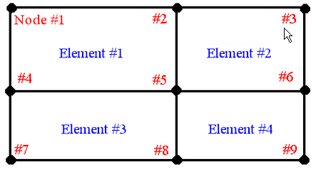

Given the following figure showing four elements surrounding node #5 and the following stresses:
| Element Number | Node Number | von Mises Stress |
| 1 | 5 | 20,000 |
| 2 | 5 | 15,000 |
| 3 | 5 | 19,000 |
| 4 | 5 | 10,000 |
If the maximum stress in the model is 25,000 (at node 9 for example), the precision at node 5 is
precision node 5 = 0.5(20,000 - 10,000)/25,000 = 0.20
