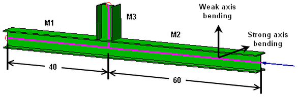

Define Members
During code checking, multiple beam elements are combined into members, where the length of each member is used in the allowable stress calculations. The lengths for bending about the weak axis and about the strong axis are separate values.
The creation of members is done in the Results environment. The following outlines how these are created. The code checking calculations are computed based on the group of beam elements in the members, not the individual beam elements.
Two adjacent beam elements are considered to be part of one member if:
- They are in the same part.
- They have the same cross section.
- They are colinear.
- There are no beam end releases or offsets at the common node.
- There are the only 2 elements (of any type) coming together at the common node.
- There are no boundary conditions or boundary elements applied at the common node
If any of these conditions are not met, a member would be terminated and the next element would start in a new member.
