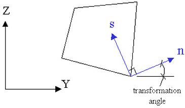

Next, specify the material model for this part in the Material Model drop-down box. If the material properties in all directions are identical, select the Isotropic option. If the material properties vary along three orthogonal axes, select the Orthotropic option. If the material properties vary with the temperature, select either the Temperature-Dependent Isotropic or Temperature-Dependent Orthotropic option. If the Orthotropic or Temperature-Dependent Orthotropic option is selected, you can orient the material axes using the Principal Axes Transformation Angle field. The local n material axis will be measured this distance counterclockwise from the Y axis as shown in the following figure.
Figure 1: Principal Axes Transformation Angle
