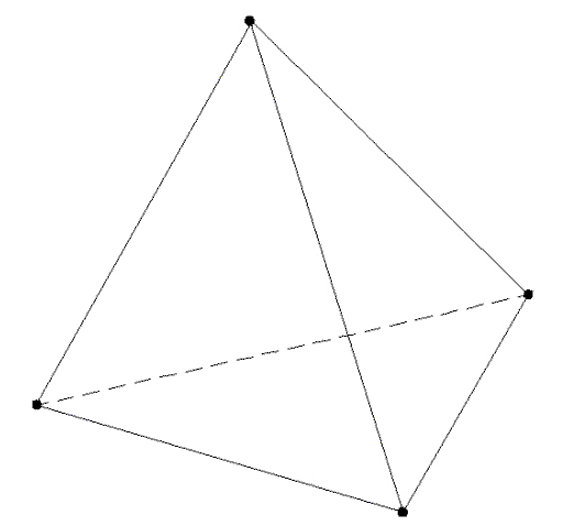

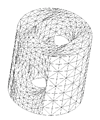

Tetrahedral elements are 4- or 10-node isoparametric or sub-parametric curvilinear tetrahedra. Figure 1 illustrates some typical elements. Figure 2 shows an example of a tetrahedral element.
Figure 1: A Typical Tetrahedral Element
Figure 2: A Typical Application for a Tetrahedral Element
