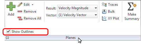

1. The next steps are easier if we resume the plane outline. Click the drop down menu on the Planes context panel, and check Show Outlines:

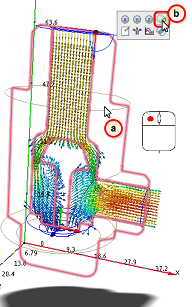

2. We can create traces on a plane located anywhere, but the inlet is often the most convenient place. To align the plane to the inlet:
  1. Left click on the plane.
  2. Click the align to surface icon.
  3. Click the valve inlet.
You should see this:

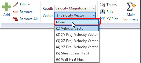

3. To improve visibility, we should disable the vectors. Select None from the Vector menu in the Planes context panel:

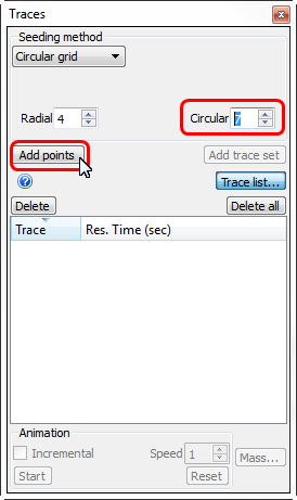

4. To create traces, click Traces:

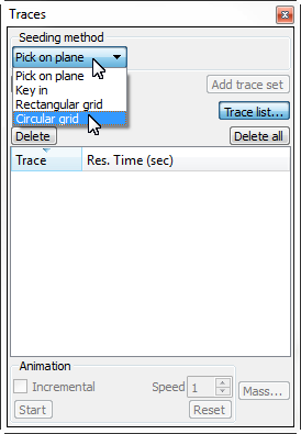

5. On the Traces dialog, select Circular grid:
6. Enter 7 in the Circular menu, and click Add points.

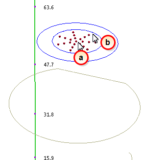

7. To create the trace seed grid:
  1. Click in the center of the inlet.
  2. Drag the grid to the outer edge of the inlet.

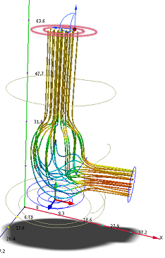

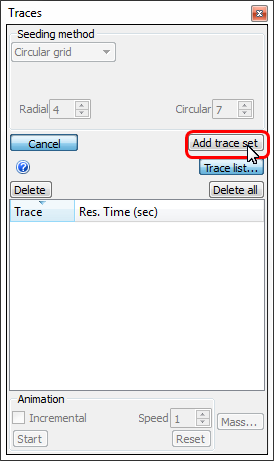

8. Click Add trace set to finish:
Note: This is an interesting view, but it would be better to see how the traces interact with the solid parts.

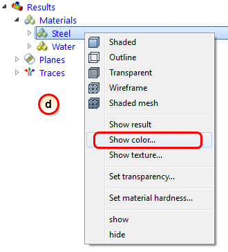

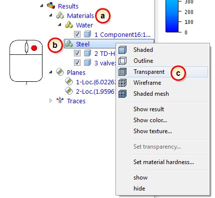

9. To display the pipe and poppet transparently:
  1. Expand the Materials branch (under Results) in the Design Study bar.
  2. Right click on Steel.
  3. Click Transparent.

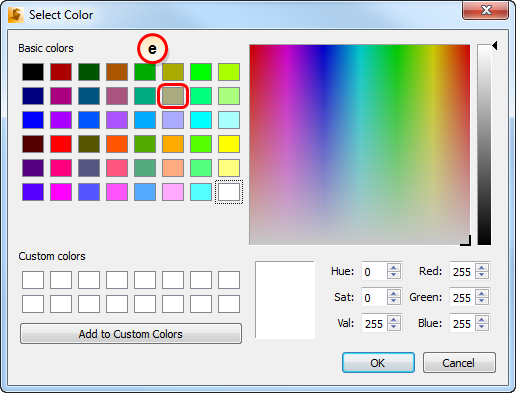

  4. Right click on Steel again, and select Show color...
  5. Select this color on the Select Color dialog, and click OK.

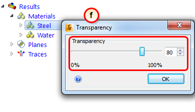

  6. To see the traces better, right click on Steel again, and click Set Transparency. Drag the slider to 80%.
That's better! This helps us understand how the flow moves through the valve. The traces are colored by velocity magnitude, so we can also see how the flow accelerates as the water enters the outlet pipe.
