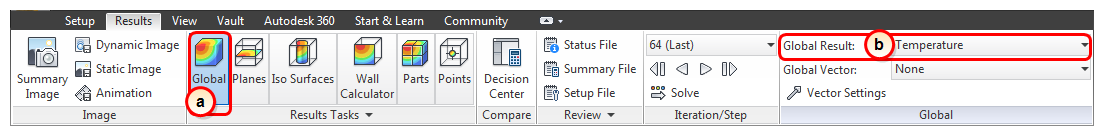

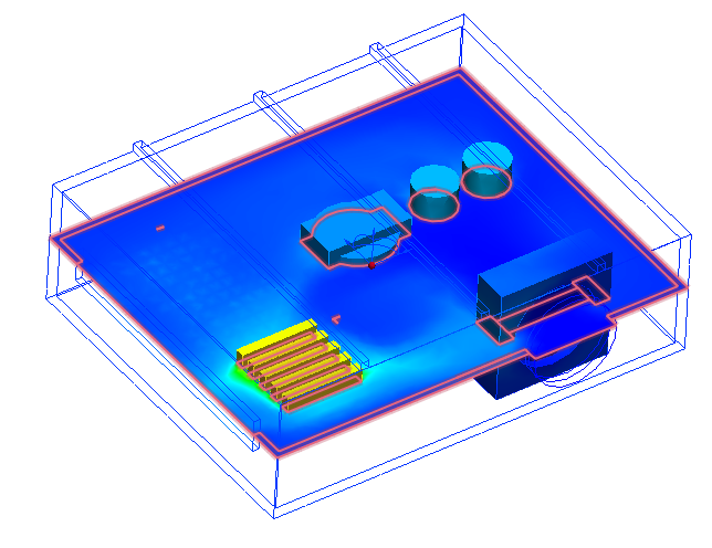

1. To display Temperature on all parts:
  1. Click Results > Results Tasks > Global.
  2. Select Temperature from the Global Result menu...
You should see this:

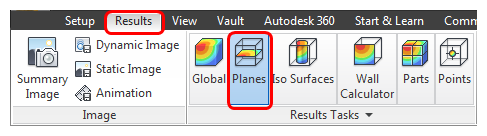

2. Click Results (tab) > Results Tasks (panel) > Planes.

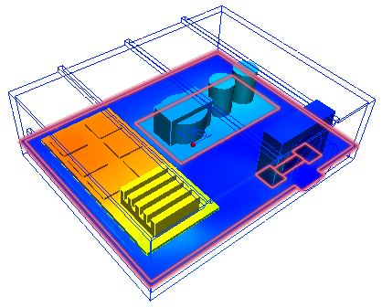

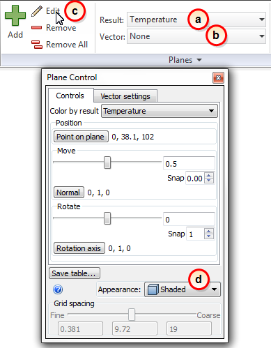

3. Display temperature on the plane and hide the vectors:
  1. Select Temperature from the Result menu on the Planes context panel.
  2. Select None from the Vector menu on the Planes context panel.
  3. Click Edit from the Planes context panel.
  4. Select Shaded from the Appearance menu.

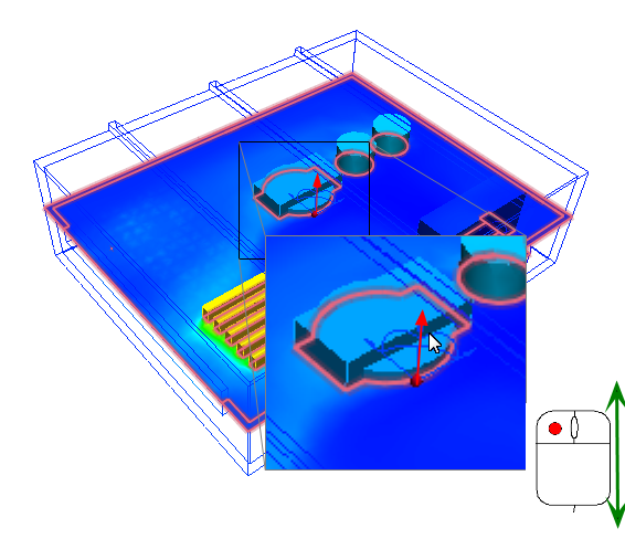

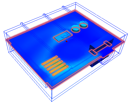

Note: To see more of the temperature distribution, move the plane...
4. To move the plane, left click on the perpendicular axis and drag the plane downward.
As you move the plane through the enclosure, you should see this:
These views show the temperature of the air and components throughout the enclosure. Because the component temperatures are one of the most important results of any electronics enclosure simulation, we should extract some of these temperature values.

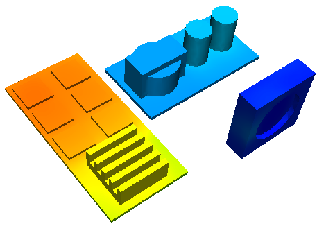

7. Hide the enclosure and air parts by holding Ctrl and middle clicking on both. You should see this:

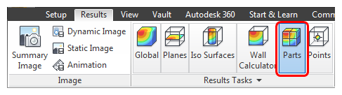

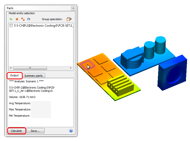

8. Click Results (tab) > Results Tasks (panel) > Parts.
9. Select a small chip, and click Calculate. The temperature appears in the Output tab:
10. Repeat with the other parts to view the component temperatures throughout the enclosure.
Note: This procedure shows the exact temperature of each selected component. You can pick them individually or together. We can see that the temperature of the six chips is close to the recommended maximum of 60 °C.
