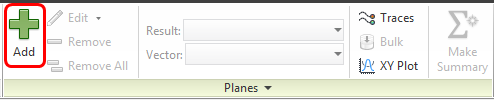

2. To create a plane, click Add on the Planes context panel.
You should see this:

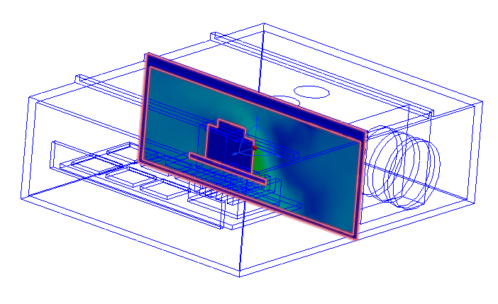

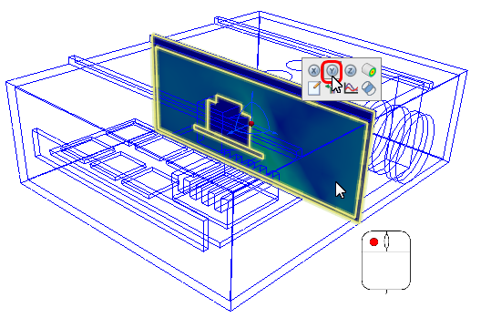

3. To rotate the plane, left click on it, and click Y from the Context dialog:

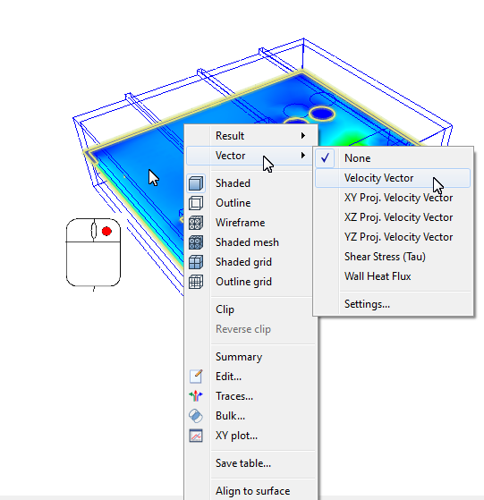

4. To show vectors on the plane, right click, and select Vector. Click Velocity Vector:

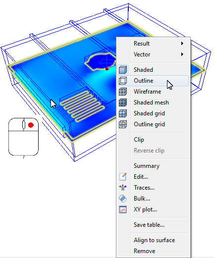

5. Until you view the plane as an outline, the vectors are difficult to see. Right click, and select Outline:

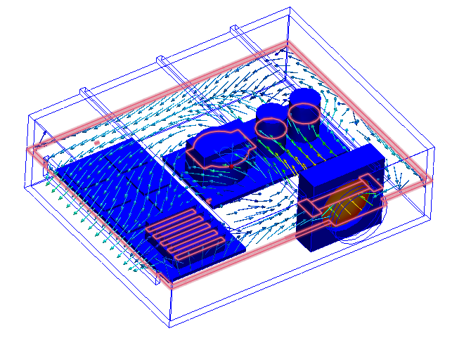

6. To improve the view, shade the internal components:
  1. Change the visual style to Shaded, from the Quick Access toolbar.

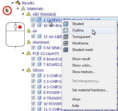

  1. To display the casing and the air as outline, right click on Casing from the Results > Materials > ABS (Molded) branch of the Design Study bar, and click Outline.

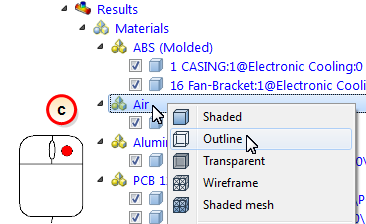

  1. Right click on Results > Materials > Air, and click Outline.

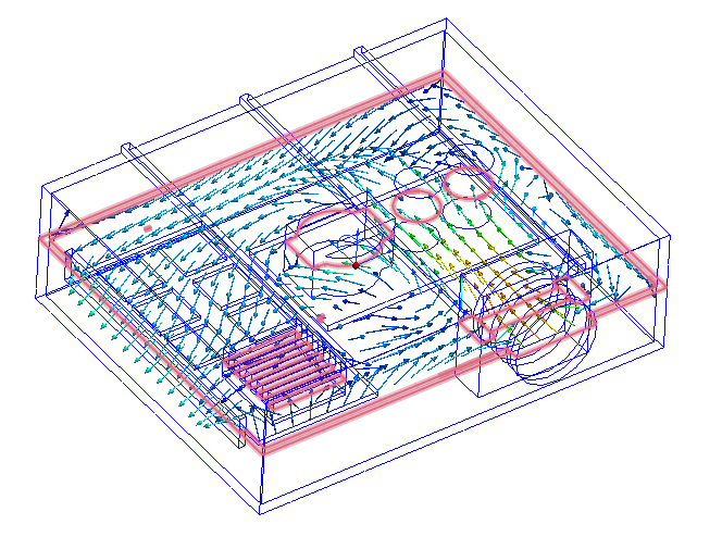

This is a good view of the flow through the enclosure. Notice the recirculation to the left of the fan. This air probably does not cool the components. Notice also the strong jet that flows over the transformer and capacitors. After impinging on the back surface, the jet flows over the six chips on the PCB.
